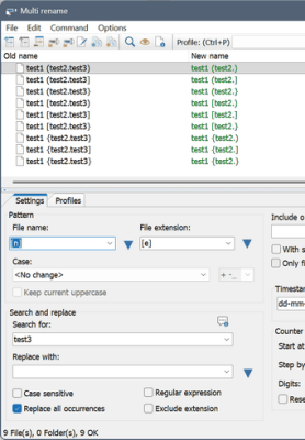

There is this peculiar mismatch in treatment of full names
The name of item will succumb to replacement when user enters proper data in
Multi rename > Settings > Search and replace > Search for
and
Multi rename > Settings > Search and replace > Replace with
fields even if the field of
Multi rename > Settings > Pattern > File name
has the default
[n]
in it
But extension of a file will not be affected if the field of
Multi rename > Settings > Pattern > File extension
has the default
[e]
in it
At first I thought this was a bug related to closing parenthesis of all kinds, thus created these examples
But you can literally test-out them i.e. try to remove the
test3
from them or anything that is placed in them after the dot sign using the Replace with field - and you will see that you will fail
Therefore I think this is at least a wrong concept if not a plain bug. Because why does the
[n]
is ignored / adjustable while the
[e]
gets to be obeyed / unchangeable, if both of them are the default values that use original strings as basis for renewed data?
I am using Build 946 64-bit Donor Portable & Build 941 32-bit Public Installed

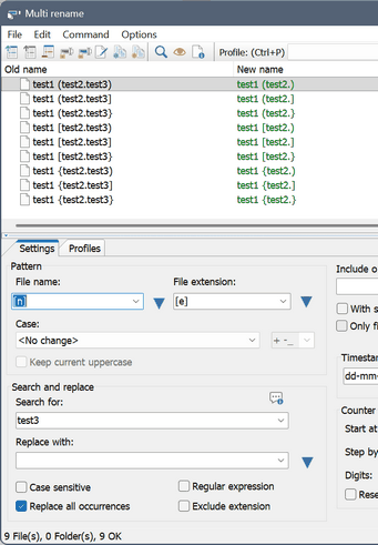

I see no problem:
Re: Incontinent treatment of full names by the Multi Rename tool
#3 Post by Forez » 16.04.2026, 16:15
I simply forgot to turn off the
Multi rename > Settings > Search and replace > Exclude extension
option
Me molto stupido
