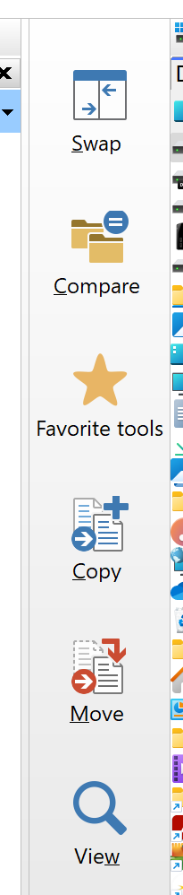

#2 Post by Dreamer » 21.01.2024, 18:37
Probably confirmed, not sure if it's the same, to reproduce:
- in Define action toolbars, for Splitter use option "Show captions", "at the bottom"
- option "Use small font" can be enabled or disabled
= result is truncated captions and icons/buttons, even in maximized view and fullscreen mode
I tried to remove few buttons, resize window manually to max. height, still the same.

#3 Post by Marek » 21.01.2024, 18:51
No problem here ("Use small font" disabled):
Of course you should adjust the button size.
