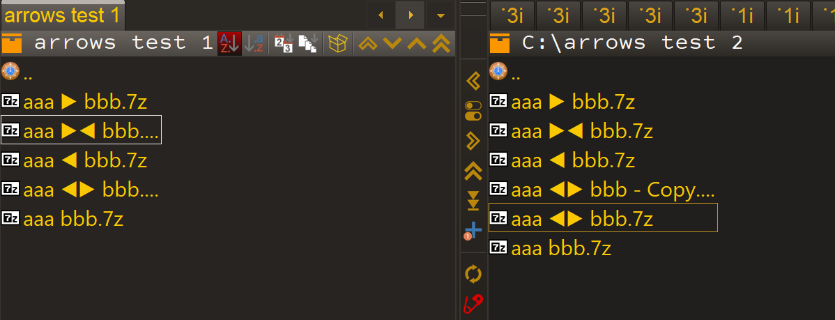

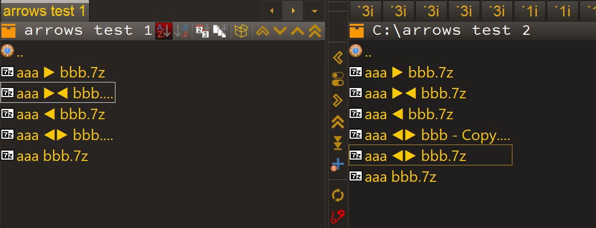

#1 Post by Forez » 04.04.2026, 16:07
Usage of precisely
and / or
pack of signs makes name of a file that uses them be truncated at its end with
indication, even if the name is very short
The below screenshot tells it better:
Take notice of how creation of
aaa ◀▶ bbb - Copy.7z
i.e. a system-automatically-named copy of
aaa ◀▶ bbb.7z
healed the original by transferring the glitch to that said duplicate. This also healed the
aaa ▶◀ bbb.7z
I am using Build 946 64-bit Donor Portable and Build 941 32-bit Public Installed on Windows 10 IOT Enterprise LTSC 21H2 x64 (19044.6691)

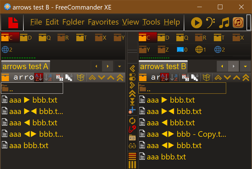

Re: Display of file name is broken by filled horizontal pointing triangle signs ◀▶ and ▶◀
#5 Post by Forez » 13.04.2026, 19:38
I also get the same correct result when using default settings
But my personal settings truncate names of files
#6 Post by Forez » 19.04.2026, 15:26
I have pin-pointed the culprit in my
FreeCommander.ini
which is the
FileListFont_Size=
value - assuming I also use
FileListFont_Name=Segoe UI
The truncation happens if the FileListFont_Size value is set above 9 i.e. when the font is 10 or higher, but I can use e.g. 13 without side effects if I delete the FileListFont_Name line
