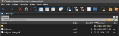

Please have a look at the attached screenshots. The first one is from Windows Explorer which lists the correct contents. The second one is from the Windows command prompt where the "dir" command also outputs the correct contents; the second screenshot also shows that there is nothing special with the attributes of the files in that directory. The third screenshot is from FC which lists the wrong contents.
As we can see, FC does not list the file "ReAgent_Merged.xml1" which definitely exists (I can open it with any text editor using Windows explorer, change it and save it), and lists the file "Winre.wim" which definitely does not exist.

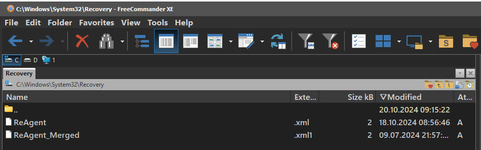

#2 Post by horst.epp » 20.10.2024, 11:22
Not confirmed

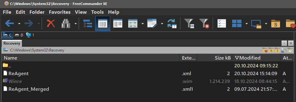

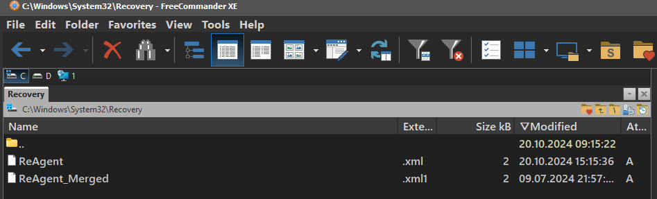

#5 Post by horst.epp » 20.10.2024, 15:20
I tried your scenario.
No problem with FC.
It works perfect here under Windows 11 24H2.
The screenshots show the FC display after disabling and after enable it again.
