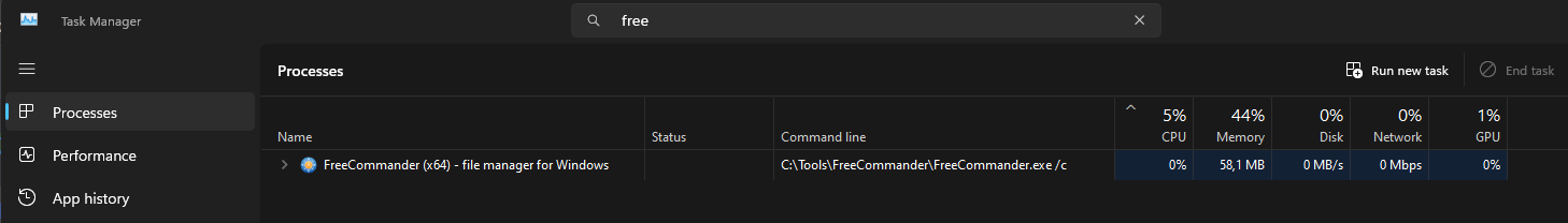

I'm using FreeCommander XE 2024 Build 901 on Windows 10. Task Manager shows FreeCommander constantly using between 1% and 4% CPU even when the program is in the background idling not performing any tasks. What configuration setting or feature would cause this?

Both my Build 910 64-bit Donor Portable & Build 901 32-bit Public Installed seem to working A-OK
And what is more, recently I have been having on my non-updated Windows 10 strange inexplicable usage of CPU percentages by 2-3 various programs to the point of inevitable system crash- but FreeCommander stays at 0% when it is idle
