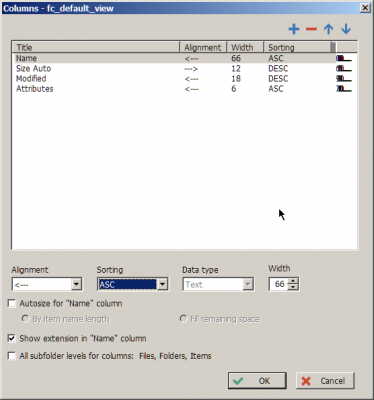

#2 Post by Marek » 14.09.2022, 18:12
Please check your column profile:
- select the "Name" line
- at the bottom check "Sorting" value
- it should be ASC in your case

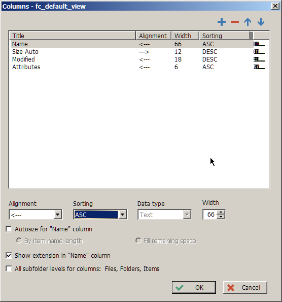

#3 Post by ok1 » 15.09.2022, 03:27
Thanks for the suggestion. I don't have any custom column profiles, just have the fc_default_view and 'Name' appears to have ASC as you suggest, see below.
Note I have tried deleting and then adding the toolbar buttons which was a suggestion from a forum post.
