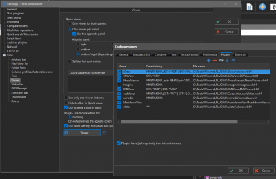

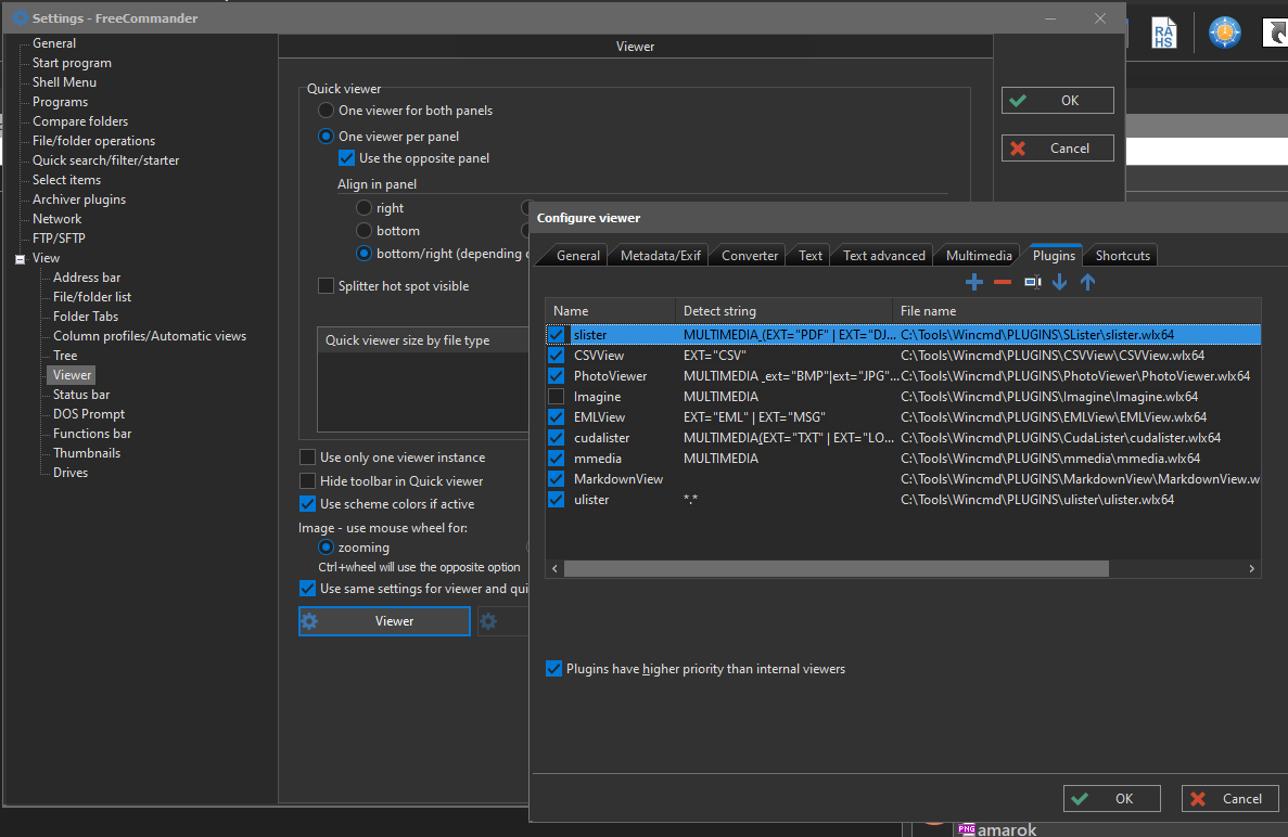

Re: epub viewer
Viewer Plugins are not installed this way.
Use the following steps:
Settings / View / Viewer
Button Viewer and then the Plugins tab
Take the + option and add the SLister plugin from where you stored the expanded archive.
Looks like this for me
Don't forget to change the SLister.ini entry
to point to the installed SumatraPDF
or update the files in the SLister plugin dir with the actual ones from
https://www.sumatrapdfreader.org/downlo ... pdf-viewer

Re: epub viewer
I tried all your steps, but still the QV shows epub as junk characters.
Your screenshot shows C:\Tools\Wincmd path. I had used C:\Program Files (x86)\Util\, which has spaces in the name.
Sometimes the spaces create a problem.
So I shifted the folder to D:\Downloads (which is a non-Windows partition).
But this failed to solve the issue.
What could be the reason?
I have observed two potential reasons:
1. Have you used the 64-bit versions of Sumatrapdf and sLister? (Your screenshot shows "64")
I have used 32-bit versions for both.
Could this be the reason for the failure?
2. The Detect string field in the plugin dialog reads as follows:
MULTIMEDIA& (EXT="PDF" | EXT="DJVU" | EXT="DJV"| EXT="XPS" | EXT="CBZ" | EXT="CBR" )
This list does not include the "epub" extension at all.
I changed it to-
MULTIMEDIA& (EXT="PDF" | EXT="DJVU" | EXT="DJV"| EXT="XPS" | EXT="CBZ" | EXT="CBR" | EXT="EPUB" )
But this made no difference: The QV still shows junk characters for epub files.
I don't know if I have done this correctly...
But if I select an epub, and press F3, a separate window of Sumatrapdf pops up and shows the epub file properly.

Here is the step-by-step process I followed:
1. unzip the sLister files and create a folder with a suitable name.
2. Extract the portable version of Sumatrapdf into this folder (replace the outdated Sumatrapdf.exe).
3. This folder can work in any location.
4. Edit the sLister.ini file with a text editor, and change the path to the current location of Sumatrapdf.exe.
5. Start FC and add sLister as plugin; using the following steps:
5a. Select the Tools > Settings menu
5b. Choose View>Viewer node in the tree (in the panel on the left)
5c. Click on the Viewer button at the bottom
5d. Select the Plugins tab.
5e. Click on the + button to add an entry.
5f. Browse to the Sumatrapdf+sLister folder.
5g. Select slister.wlx file.
(sLister is the wrapper, so it will in turn use the Sumatrapdf.exe file).
5h. By default, sLister does not have "epub" in its list of extensions.
So you have to add this extension manually.
To do this, click on the Edit button in the toolbar.
Enter this string at the end
(Note that there are spaces on both sides of all words.)| EXT = "EPUB"
The edited string looks like this: MULTIMEDIA& (EXT="PDF" | EXT="DJVU" | EXT="DJV"| EXT="XPS" | EXT="CBZ" | EXT="CBR" | EXT = "EPUB" | EXT = "AZW3" )
5i. Click on the OK button to save and close.
5j. Close the higher-level window ("Settings") also by clicking OK.
6. Restart FC.
Now the Quick Viewer will start showing the preview for pdf and epub files.
