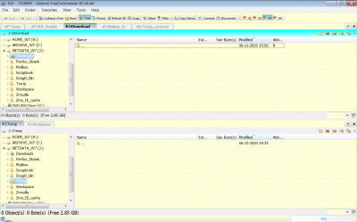

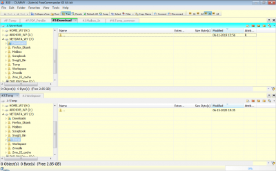

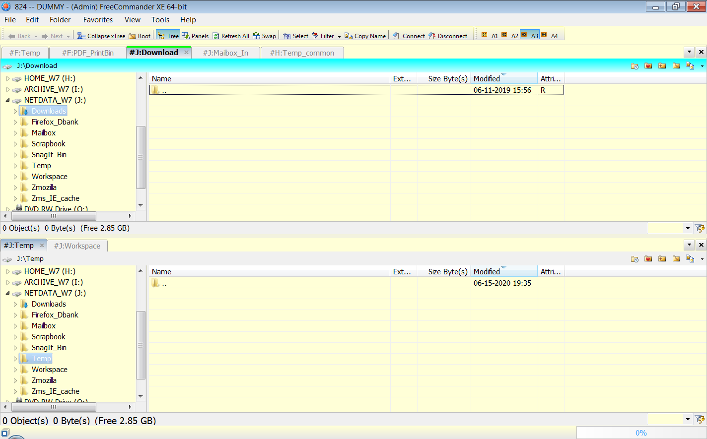

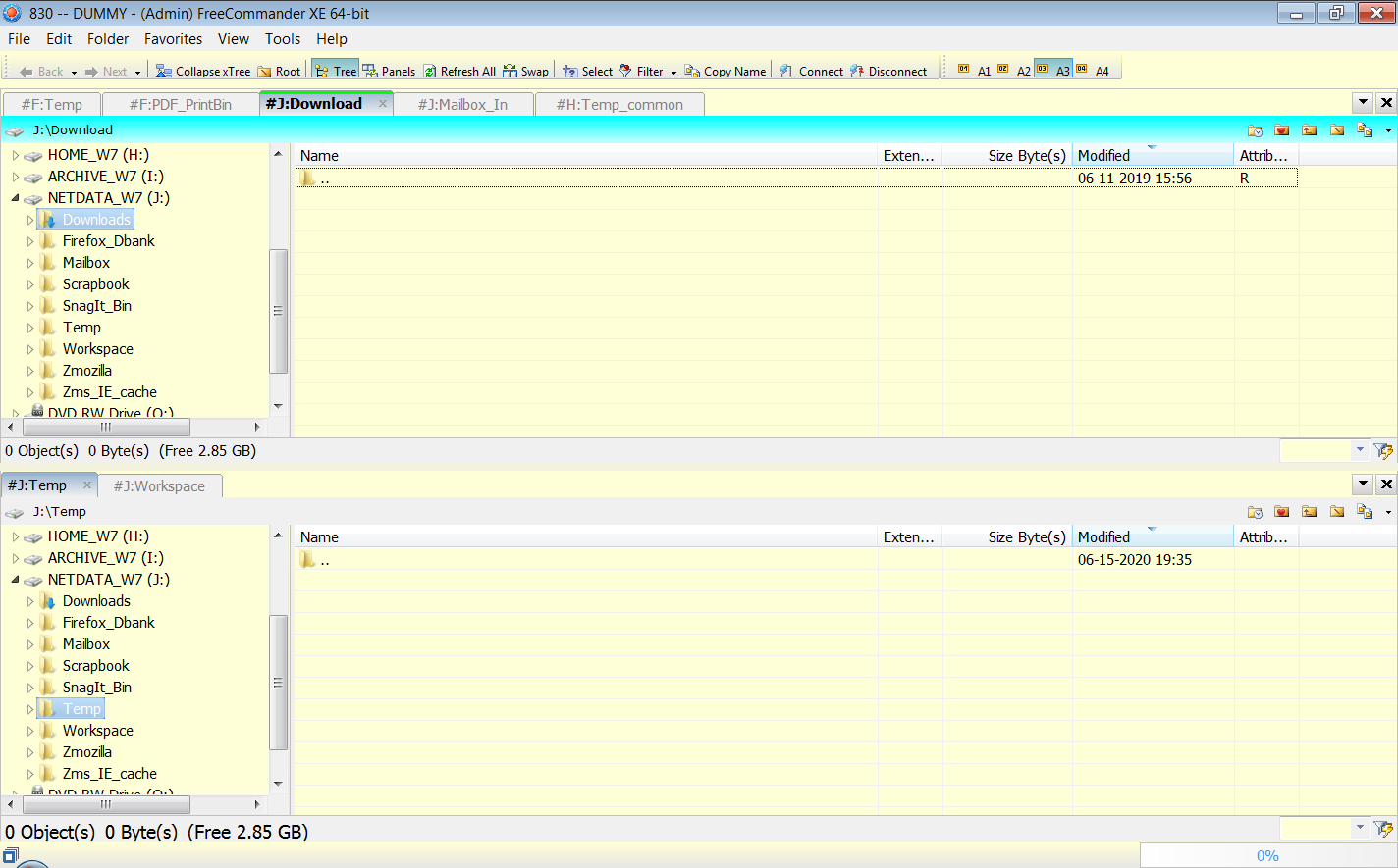

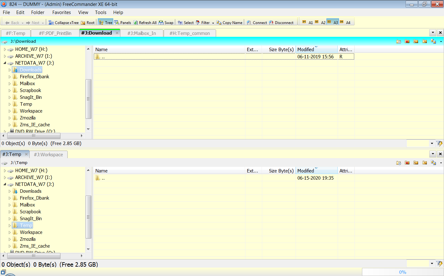

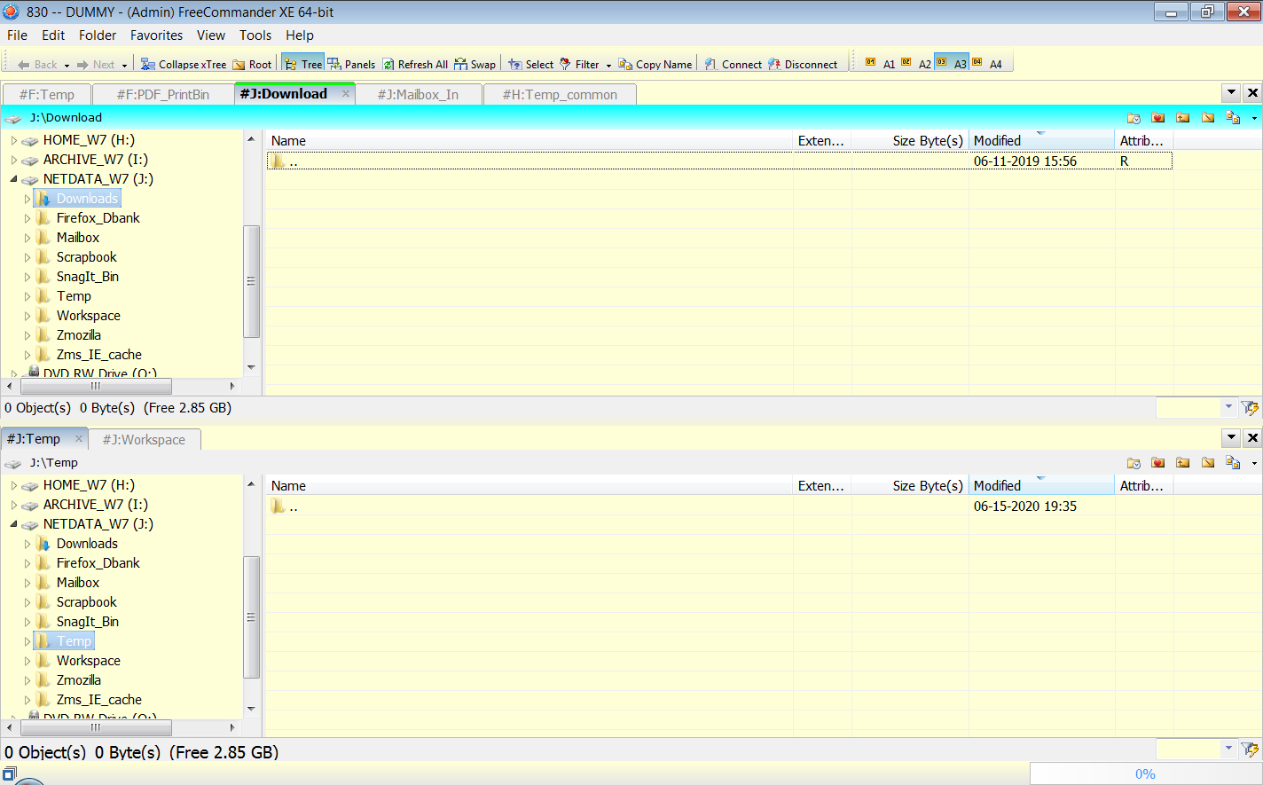

I have attached three more bits of information:
-- screenshots of the column sizes before and after the update to v830 from 824
-- an HTML diff file which I created to compare the v830_Raw to v830_Saved core user Dummy.INI file
As I noted earlier, this same experience pre- and post- update applies to v825-v830.
Hope you can shed some light on this issue.
Many thanks, Marek, for your continuing support for a tool which is critical to my workflow.
Regards, Cecil

Re: Versions After v824 Not Respecting Column Profiles?
There really was a change in how the column width is calculated. FreeCommander currently scales itself and Windows did it before. It may be that there are small differences.
But I wouldn't see that as a big problem.
Change the column width as you want and then stay that way.
