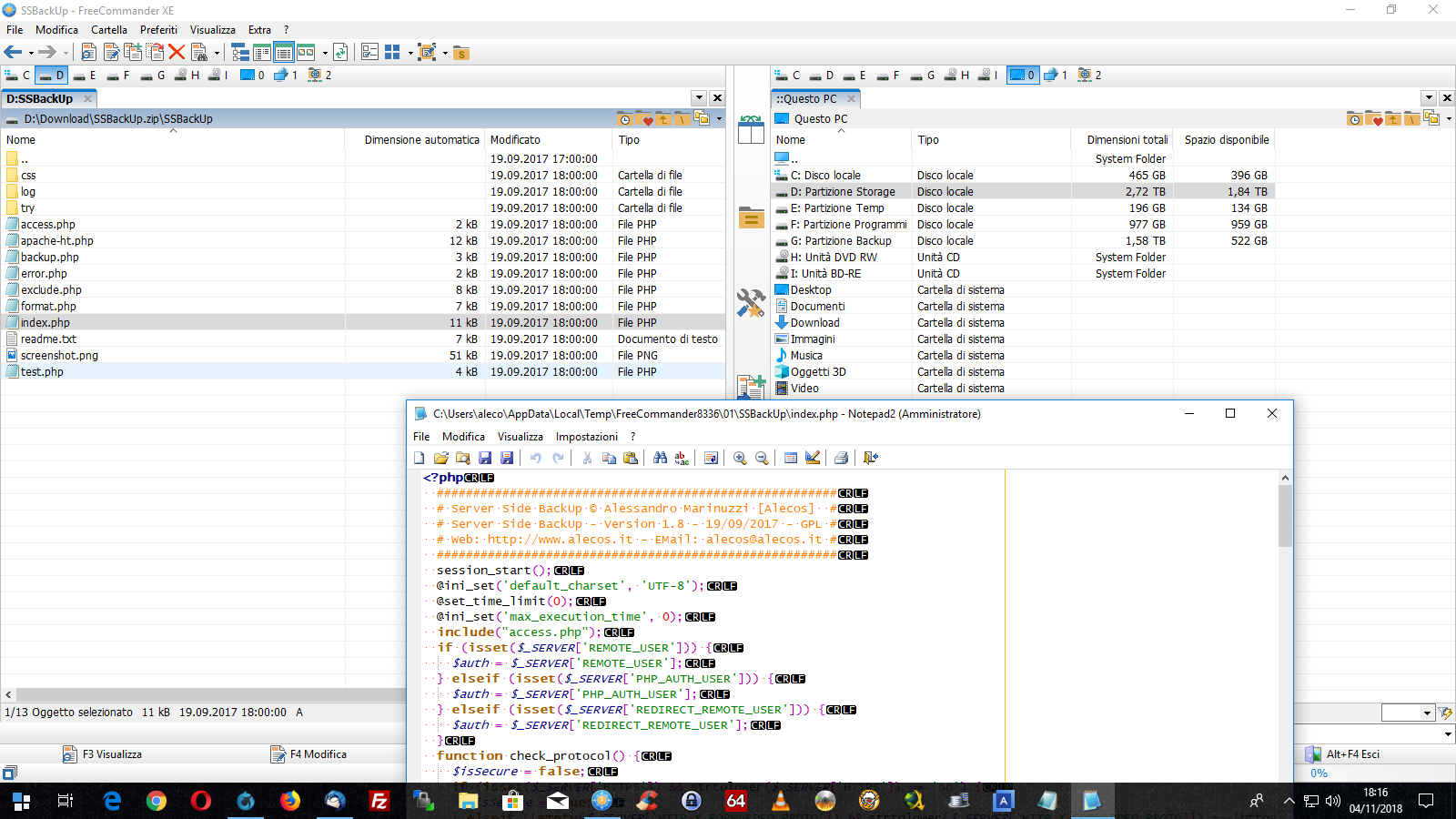

FC crashes when I read files inside a zip file...
I was reading files inside a zip file using FreeCommander... then I closed FreeCommander and this crashed... I sent my bug report to bug[at]freecommander.com, this time the crash occurred using version 786...
- Attachments
- Cattura.PNG (10.24 KiB) Viewed 28365 times

I mean "doubleclick" on the file inside the archive to view it... I attach a screenshot... the plugin zip is part of freecommander... I think... and now crashed again...Marek wrote: 04.11.2018, 17:44 No problem here but it would be nice if you could provide exactly step by step description how we can reproduce the problem with your archive file.You mean "open" the file (as per double click) or view with F3?also click on files inside the archive to view
