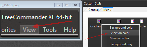

That's not itDreamer wrote: 28.03.2018, 23:59 It's the same place as menu and toolbar:
Menu > View > View style > Gradient - Custom > Define... > Menu tab* > Gradient start > Selection color
Menu > View > View style > Gradient - Custom > Define... > Menu tab* > Gradient stop > Selection color
These two control how a single horizontal "highlight bar" looks like in the right mouse button menu- so something after I click [and it is not even that element I am trying to affect]
I am talking about the color to which changes File or Edit or Folder or Favorites or View or Tools or Help "menu button", when the pointer is over it. [Previously I gave as an example >>"Menu" in Menu<< - which apparently in FC does not exists]
I have also been through all of the options, one by one, up there in "Define..."- and I was unable to see a change I desire. Maybe this color of that element is just a derivative of some other setup color; thus not controlled directly? It may be a coincident, but I noticed in all of the schemas I tried out that this color is similar to other used within a given schema [so not something like bright yellow in a grey themed one but some greyish]- and also in mine own dark grey / black schema created from scratch this color is black. But then again: I also have looked throughout the options for black or near black color, changing every instance of it within my schema that I could spot to something like easy to notice [and not used y me anywhere else] magenta- and I did not see a change in the menu in the end

Main menu items use the same color. What exactly do you want, menu background hover color, or text color?
Perhaps the best would be to post some screenshot and use some red arrow to element you want to change.

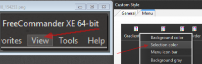

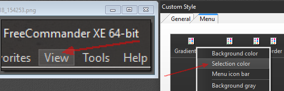

This is the state when my pointer is over the View element. It is the original state [minus the not pointer not captured by the screenshot]: the color of frames are coming out from FC settings- as is the color of View section. As you can see, it has color #161312, darker than the rest- and I want to change that #161312

Just to make sure, do you mean that background color inside the View item, as on this screenshot, right?
Which OS are you using? As I said, you can change this color using these two options:
Try to change these colors to red, if your color will be the same, try to test with default settings.

Yes, that is exactly the color I want to changeDreamer wrote: 01.04.2018, 15:54 Just to make sure, do you mean that background color inside the View item, as on this screenshot, right?
Windows 7 x64
FreeCommander XE 2018 Build 770 32-bit public
I did back then and I did now. And now I also have switched to Default White schema and tried to change it; also with reopening of the FC and checking if the change was saved [just to make sure]Dreamer wrote: 01.04.2018, 15:54 As I said, you can change this color using these two options:
The result is the same: it is visible even right down there at
because now those four positions right there [Gradient start, Gradient stop, Font, Border] have this red color when I hoover over them; but the View [and other main Menu items] are still being highlighted when hoovered upon in a way you can see on that fragment of screenshot I have provided
I also now loaded up the Dark Grey Flat Default schema and made the same change- with the same result. That red appears in various places, but not in the main Menu. In Menu it stays the same: #42a7ff / RGB 66 167 255

OK, I have the red and yellow colors, when using my custom settings and default settings, I tried also with 770 32-bit public, could you try it last time with default settings, please? Just to make sure it's not some FC option.
Try to reproduce a bug with default settings and without plugins. To do this, use these command line parameters if you are using a standard setup version (your custom setting files will be preserved):

OK, it looks it's the option "Many toolbars - Show menu as toolbar", I have a light blue color with your "bug" schema file.
I think it's not a bug, because Menu become a toolbar with this option.
So, you need to change this option:
Menu > View > View style > Gradient - Custom > Define... > General tab > Gradient start > Selection color
Same color will be used for toolbar button selection gradient start.
