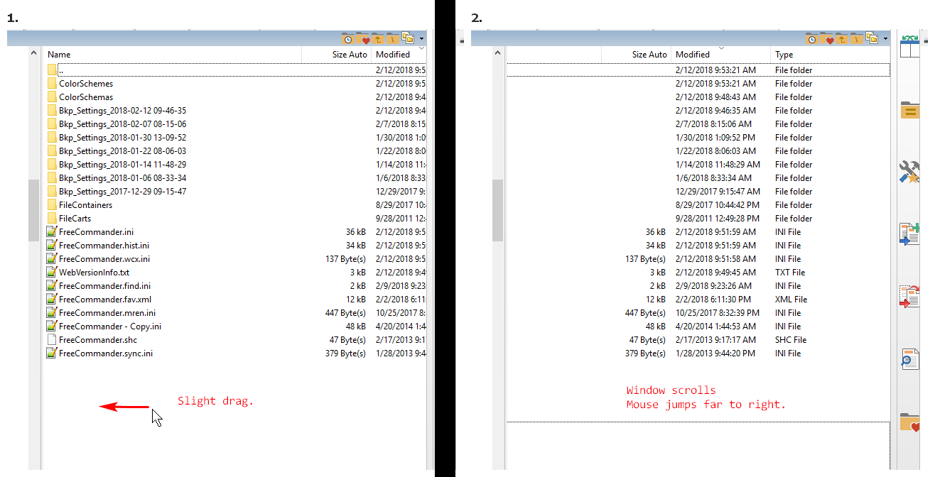

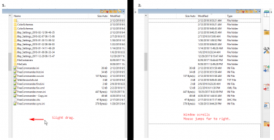

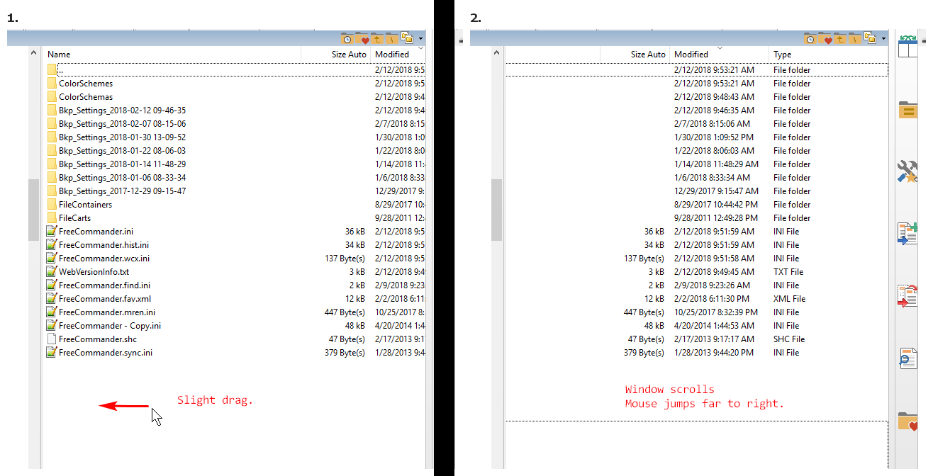

Same issue here. FC 771 64-donor_setup
This happens when selecting in the empty space in a pane which can be horizontally scrolled to the right.
Win 10 64.
Thanks.
Win 10 64.
Thanks.
