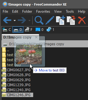

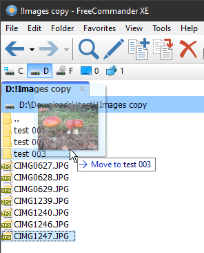

I'm not sure what you mean by "tooltip with the folder option"
fc Drag & Drop Destination Highlight_1.png (45.48 KiB) Viewed 516167 times
fc Drag & Drop Destination Highlight_2.png (43.85 KiB) Viewed 516167 times
BTW What is your OS?
