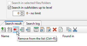

On Search Files window add buttons to the tool bar that are found under Files. For example: Remove from the List and Compare Two Files are missing on the tool bar; I can find no way to add them.

"Remove from the List" is there, install the latest version - 830 public beta.

I installed the beta (latest version) and still no "Remove from the List" or "Compare Two Files" icons on the Search Results tool bar.

Here is the screenshot from 830 public beta:
Please, create the new topics for the other issues, one per issue, in correct forums.
