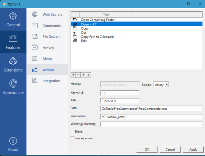

Hi
I am using Listary 6 (Beta), and it has a direct control to integrate with FC. (Options > Features > Integration >Freecommander).
Once we select that option, the screen only shows two checkboxes, and no further control.
We are supposed to place a tick in them, and that's it.
This option is meant for folders only; not for files.
I want to select a file in the search results of Listary and open its containing folder in FC.
FC should open the containing folder and then place the focus on that file.
The reason is, I know that there are many other files on the same subject in that folder.
So I want to locate a file quickly using Listary, but after that, I want to stop using Listary and use FC to browse that folder.
But if I right-click on a search result in Listary and select the "Open containing folder" option, Windows switches to FC.
But FC does not load that folder.
I guess I haven't set the correct parameter in Listary's settings.
So the question is, what parameter should I user in Listary so that it invokes FC with the selected file's path as parameter?
Re: FYI: Listary and FCXE

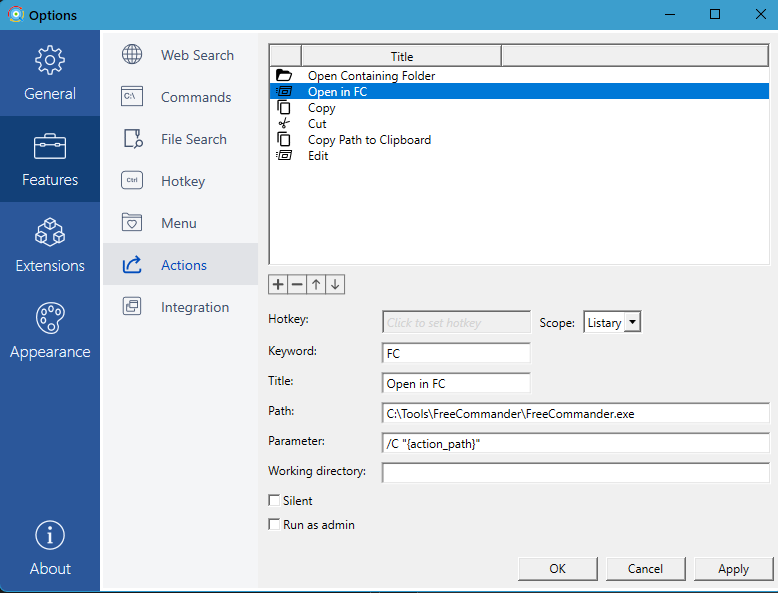

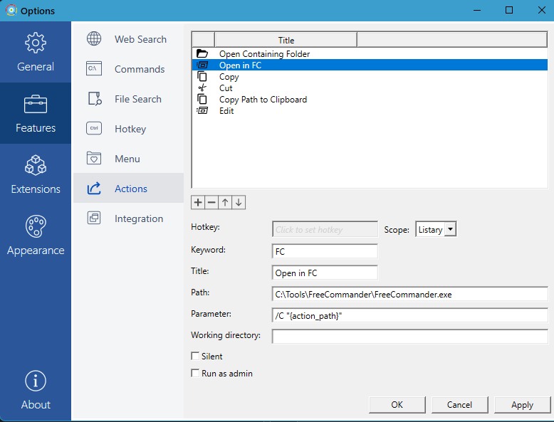

#23 Post by horst.epp » 18.03.2022, 14:12
The following Action works for me.
I named it "Open in FC".
It works for files and folders.
You have to change the path to FC for your environment.
Raindrops
Posts: 49
Joined: 20.12.2021, 08:36
#24 Post by Raindrops » 20.03.2022, 04:07
Thanks! It works fine.
I also added a hotkey, which makes it even faster.
BTW I copied the parameters as shown in your screenshot (/C "{action_path}")

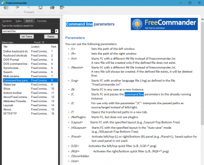

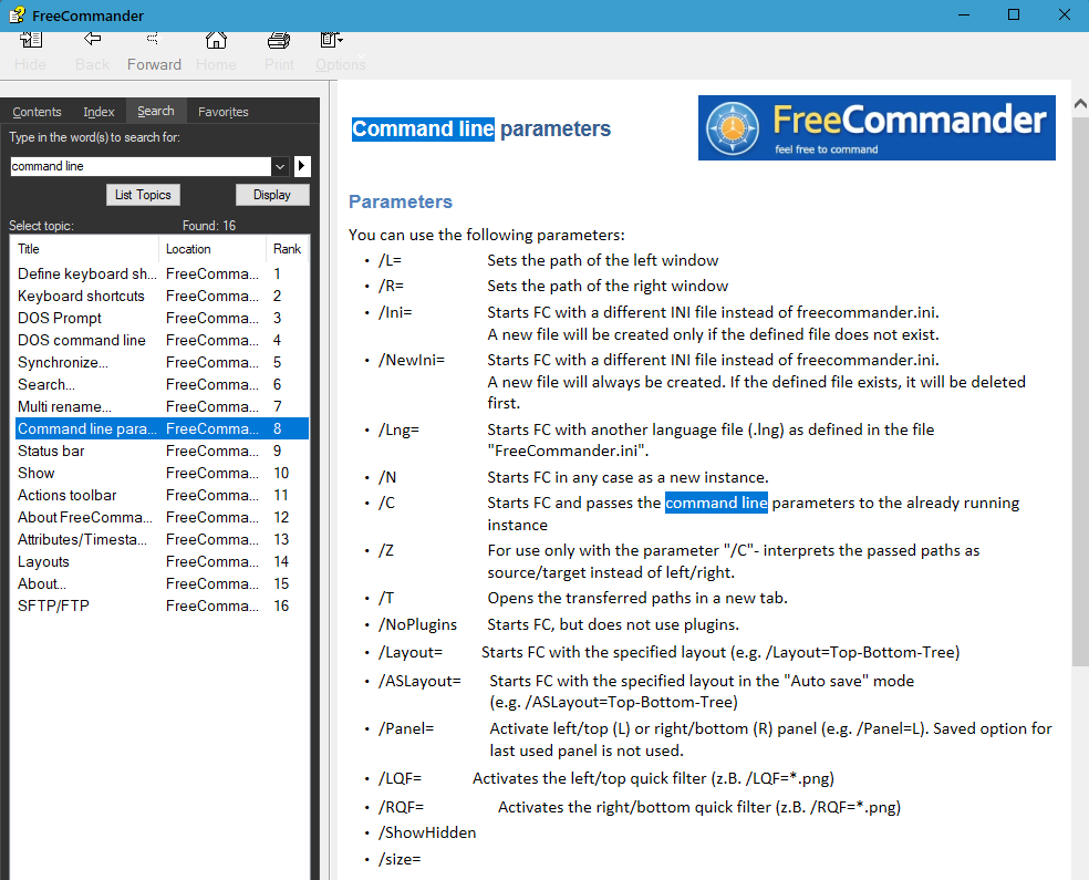

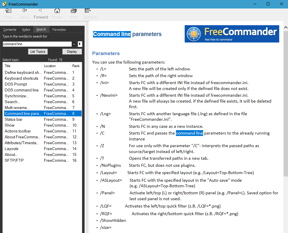

However, I wonder if there are more parameters that I can use in other contexts.
The help file for FC explains /C as a Command line parameter.
But it does not mention/explain "{action_path}" as a CL parameter.
Probably I am missing out a few powerful ways to use FC.
Could you elaborate where I can find these options?
#25 Post by horst.epp » 20.03.2022, 08:25
FC Help, search for command line, to find all options.
The parameter "{action_path}" is part of Listary and inserts the search result into the FC command line.
